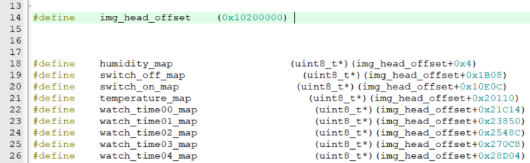

]]></description><link>http://www.freqchip.net:4567/post/4415</link><guid isPermaLink="true">http://www.freqchip.net:4567/post/4415</guid><dc:creator><![CDATA[而优则]]></dc:creator><pubDate>Invalid Date</pubDate></item><item><title><![CDATA[Reply to fr8003和fr8008gp UI_ALL.bin flash偏移地址 on Invalid Date]]></title><description><![CDATA[<p><a class="plugin-mentions-user plugin-mentions-a" href="http://www.freqchip.net:4567/uid/1938">@而优则</a> <img src="/assets/uploads/files/1779421621434-3286215f-b4e5-4077-a2ca-15b5f3cc6243-image-resized.png" alt="0_1779421620597_3286215f-b4e5-4077-a2ca-15b5f3cc6243-image.png" class="img-responsive img-markdown" /> 程序目前是这么写的，固定偏移地址就是0x200000</p>
