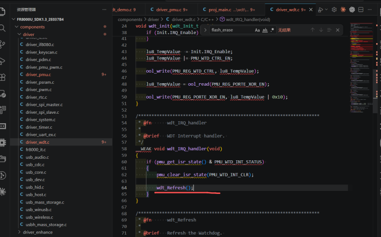

]]></description><link>http://www.freqchip.net:4567/post/4442</link><guid isPermaLink="true">http://www.freqchip.net:4567/post/4442</guid><dc:creator><![CDATA[lcy]]></dc:creator><pubDate>Invalid Date</pubDate></item><item><title><![CDATA[Reply to 休眠期间如何喂狗 on Invalid Date]]></title><description><![CDATA[<p><a class="plugin-mentions-user plugin-mentions-a" href="http://www.freqchip.net:4567/uid/1933">@lcy</a> 参考wdt的例程中的中断例程就可以，到时间会产生PMU中断，系统会自动唤醒</p>
<p>看下这个中断的喂狗方式<br />
<img src="/assets/uploads/files/1780155925958-d3783a4c-0691-4df2-8fc8-13d0c4cb79d2-%E5%9B%BE%E7%89%87-resized.png" alt="0_1780155925648_d3783a4c-0691-4df2-8fc8-13d0c4cb79d2-图片.png" class="img-responsive img-markdown" /></p>
