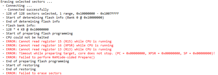

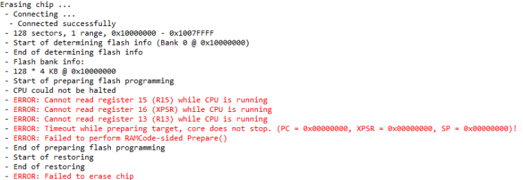

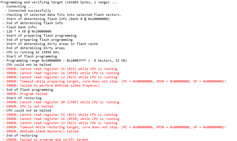

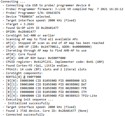

<p>when using JFlash we successfully connect to the device it's ok but sending Erase chip command we got errors or sending Erase sector we got errors also trying to Program the device results in errors.<br />
During JFlash SWD operation, the FR8000 chip seems to reset itself several times.</p>

<img src="/assets/uploads/files/1781359497621-connect.png" alt="3_1781359445506_connect.png" class="img-responsive img-markdown" /> <img src="/assets/uploads/files/1781359497592-erase-chip-resized.png" alt="2_1781359445506_erase chip.png" class="img-responsive img-markdown" /> <img src="/assets/uploads/files/1781359497586-erase-sector-resized.png" alt="1_1781359445506_erase sector.png" class="img-responsive img-markdown" /> <img src="/assets/uploads/files/1781359497634-programming-resized.png" alt="0_1781359445505_programming.png" class="img-responsive img-markdown" /><br />
which is the root cause of the situation we generated with our UART FW update attempt?</p>
