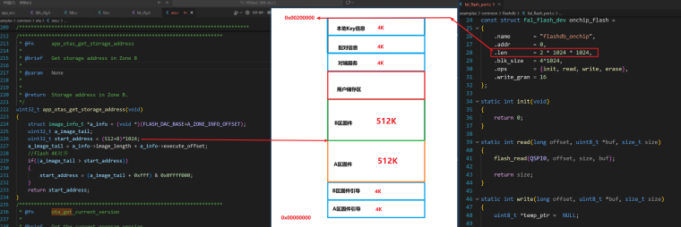

检查flashDB设置flash的大小<br />
检查OTA设置的B区起始地址<br />
<img src="/assets/uploads/files/1787828309746-b99d07cd-972a-4b42-8764-fa796c7e1741-image-resized.png" alt="0_1787828307485_b99d07cd-972a-4b42-8764-fa796c7e1741-image.png" class="img-responsive img-markdown" /><br />

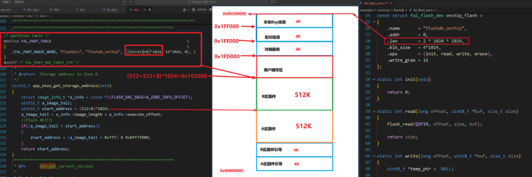

举例假设使用的是FR5098芯片flash为2M，设置ota_get_start_address的start_address为512K+8K是B区OTA的起始地址，那么用户储存区地址就是512k+512k+8k开始到到0x1FD000之前为用户区，然后flashDB的操作地址也应该是512k+512k+8k之后到0x1FD000之前都是可以操作的<br />
<img src="/assets/uploads/files/1787884767220-ff46c29e-600f-4b66-a989-e79c41c112cd-image-resized.png" alt="0_1787884765856_ff46c29e-600f-4b66-a989-e79c41c112cd-image.png" class="img-responsive img-markdown" /></p>
