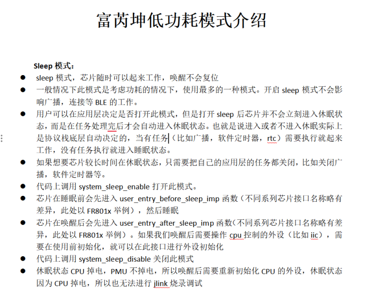

]]></description><link>http://www.freqchip.net:4567/post/4675</link><guid isPermaLink="true">http://www.freqchip.net:4567/post/4675</guid><dc:creator><![CDATA[xls]]></dc:creator><pubDate>Invalid Date</pubDate></item><item><title><![CDATA[Reply to 请问下进入休眠后还能控制io输出吗？ on Invalid Date]]></title><description><![CDATA[<p><a class="plugin-mentions-user plugin-mentions-a" href="http://www.freqchip.net:4567/uid/1747">@xls</a> 休眠后PMU还在正常工作，可以将GPIO配到PMU上来控制：pmu_set_pin_mux (GPIO_PORT_ C, GPIO_PIN_4, PMU_PIN_FUNC_GPIO) ;pmu set pin to PMU (GPIO PORT C, GPIO PIN 4);pmu set pin pull (GPIO PORT C, GPIO PIN 4, GPIo PULL NONE) ;pmu_set_pin_dir (GPIO_PORT_C, GPIO_PIN_4, GPIO_DIR_IN) ;</p>
