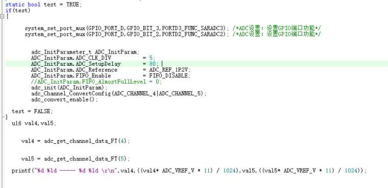

<?xml version="1.0" encoding="UTF-8"?><rss xmlns:dc="http://purl.org/dc/elements/1.1/" xmlns:content="http://purl.org/rss/1.0/modules/content/" xmlns:atom="http://www.w3.org/2005/Atom" version="2.0"><channel><title><![CDATA[SARADC使用问题]]></title><description><![CDATA[<p>system_set_port_mux(GPIO_PORT_D,GPIO_BIT_2,PORTD2_FUNC_SARADC2);该如何配置对应通道，规格书写的是PD2对应ADC通道5，有相关的例程吗</p>

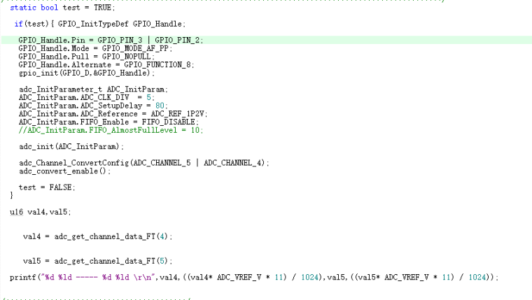

]]></description><link>http://www.freqchip.net:4567/post/4686</link><guid isPermaLink="true">http://www.freqchip.net:4567/post/4686</guid><dc:creator><![CDATA[xls]]></dc:creator><pubDate>Invalid Date</pubDate></item><item><title><![CDATA[Reply to SARADC使用问题 on Invalid Date]]></title><description><![CDATA[<p><a class="plugin-mentions-user plugin-mentions-a" href="http://www.freqchip.net:4567/uid/1747">@xls</a> <img src="/assets/uploads/files/1790067192931-9fe9f6cd-21fe-4f5c-a94d-a4ab718b0f97-image-resized.png" alt="0_1790067192602_9fe9f6cd-21fe-4f5c-a94d-a4ab718b0f97-image.png" class="img-responsive img-markdown" />上图 这样用时正常的，下图的值是不对的<img src="/assets/uploads/files/1790067267456-6c5fac25-a8f2-4e3d-bd35-d106715f7521-image-resized.png" alt="0_1790067267116_6c5fac25-a8f2-4e3d-bd35-d106715f7521-image.png" class="img-responsive img-markdown" /></p>
