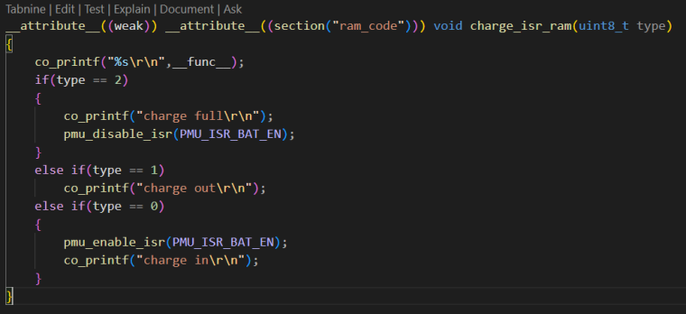

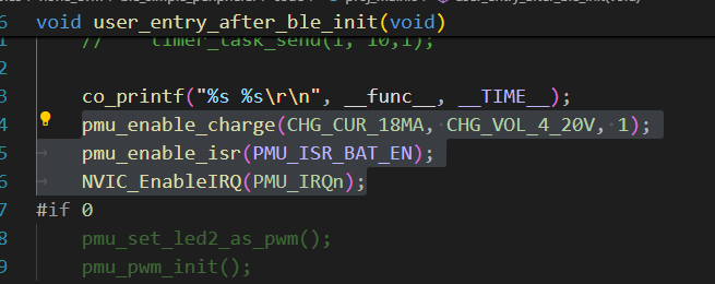

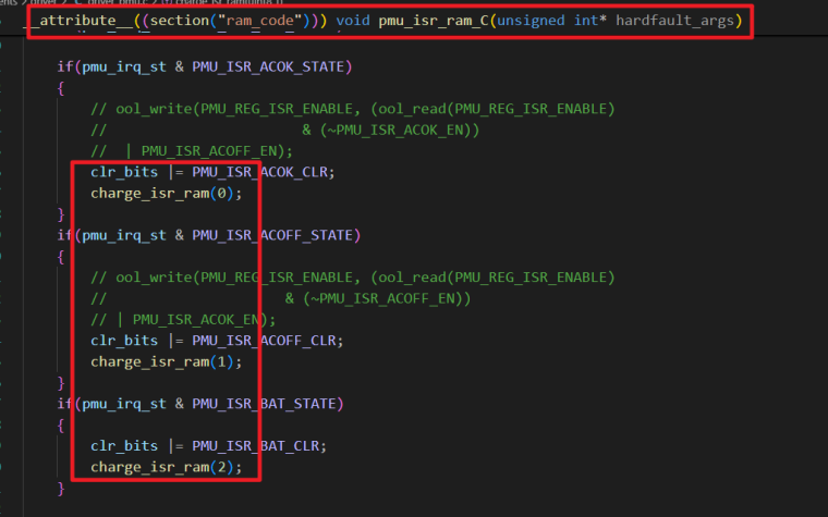

]]></description><link>http://www.freqchip.net:4567/post/2252</link><guid isPermaLink="true">http://www.freqchip.net:4567/post/2252</guid><dc:creator><![CDATA[likaisheng199291]]></dc:creator><pubDate>Invalid Date</pubDate></item><item><title><![CDATA[Reply to 关于FR8016&#x2F;8018充电问题 on Invalid Date]]></title><description><![CDATA[<p><img src="/assets/uploads/files/1733908084052-44ea4800-119f-47b1-a75a-18cf9cd0a29e-image.png" alt="0_1733908082120_44ea4800-119f-47b1-a75a-18cf9cd0a29e-image.png" class="img-responsive img-markdown" /> <img src="/assets/uploads/files/1733908109894-51a5c371-69ac-45d5-8c15-342f5b0097c7-image-resized.png" alt="0_1733908108347_51a5c371-69ac-45d5-8c15-342f5b0097c7-image.png" class="img-responsive img-markdown" /> <img src="/assets/uploads/files/1733908157740-8487fedf-6626-4e9c-b954-5dbf1cc00cc1-image-resized.png" alt="0_1733908156170_8487fedf-6626-4e9c-b954-5dbf1cc00cc1-image.png" class="img-responsive img-markdown" /></p>
]]></description><link>http://www.freqchip.net:4567/post/2286</link><guid isPermaLink="true">http://www.freqchip.net:4567/post/2286</guid><dc:creator><![CDATA[Mars]]></dc:creator><pubDate>Invalid Date</pubDate></item></channel></rss>
