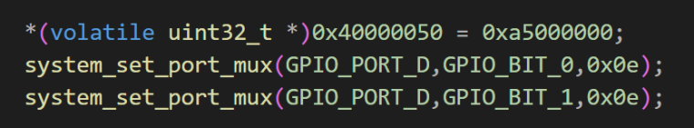

]]></description><link>http://www.freqchip.net:4567/post/2380</link><guid isPermaLink="true">http://www.freqchip.net:4567/post/2380</guid><dc:creator><![CDATA[yelong98]]></dc:creator><pubDate>Invalid Date</pubDate></item><item><title><![CDATA[Reply to 8003怎么使用125K速率实现longrange？ on Invalid Date]]></title><description><![CDATA[<p>链接：<a href="https://pan.baidu.com/s/1HGVarbiKujgCdz679akttA" rel="nofollow">https://pan.baidu.com/s/1HGVarbiKujgCdz679akttA</a><br />
提取码：ozdr<br />
代码已经写好再网盘获取<br />
打开PA的代码请看截图<br />
<img src="/assets/uploads/files/1738922217997-cdb36d7d-1e88-45fb-ba02-eb1f872a3038-image-resized.png" alt="0_1738922216550_cdb36d7d-1e88-45fb-ba02-eb1f872a3038-image.png" class="img-responsive img-markdown" /></p>
