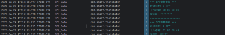

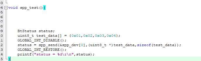

  • 发送 spp协议数据到手机上面 直接死机 0_1750756834165_5f80982c-1525-4474-ba8f-4584690563c7-image.png 手机端收到的数据如上图 实际发送的的数据是 0_1750756885788_c28f463c-8f97-461e-ab3d-b3df0730e04b-image.png KEY1 press spp send
    status = 2
    [INFO] me_callback :9,0
    Sniff Mode.
    : Interrupt frequency too HIGH!
    [HardFault]
    • Stack frame:
      R0 = 0x00000000
      R1 = 0xF00FF00F
      R2 = 0x20007700
      R3 = 0x00000000
      R12 = 0x1FFE8EAD
      LR = 0x1FFE8ED1
      PC = 0x1FFE8FE0
      PSR = 0x61000024
      flash id : ef4018
  • 你用原始的sdk会这样吗
