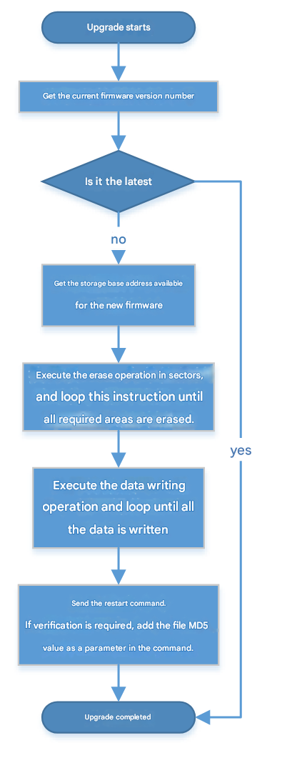

在其他文档中我还看到这张经过翻译的示意图...

In some other documents I also see this graph which i translated...

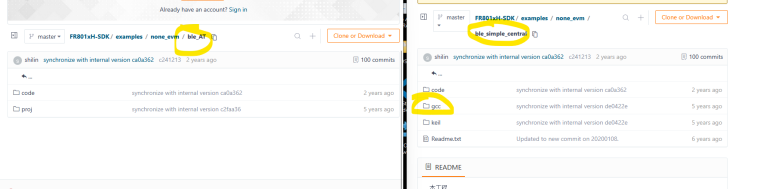

@felix-yang unfortunately that example does not contain the "gcc" directory and proper MakeFile
@felix-yang 不幸的是,该示例不包含“gcc”目录和正确的 MakeFile

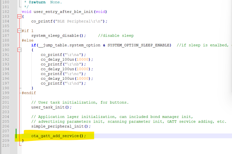

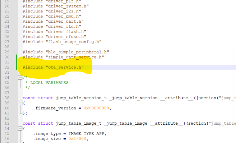

简单来说……假设我想在 https://gitee.com/freqchip/FR801xH-SDK/blob/master/examples/none_evm/ble_simple_peripheral/code/proj_main.c 中添加 OTA 更新功能
添加这几行就够了吗?!Let's keep it simple... let's say I want to add OTA update feature to https://gitee.com/freqchip/FR801xH-SDK/blob/master/examples/none_evm/ble_simple_peripheral/code/proj_main.c
Is enough to add these lines?!
是的...........
yes
