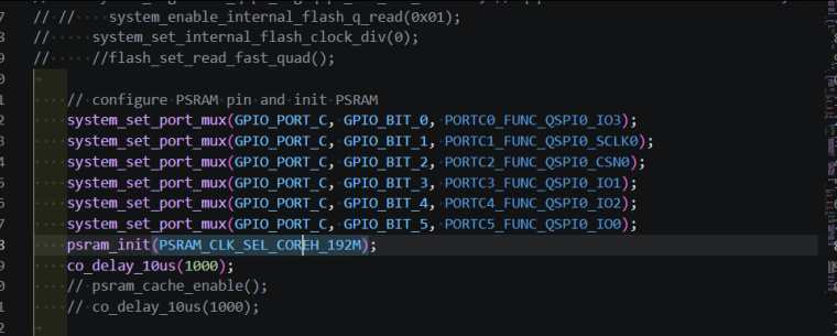

FR8008G-U 蓝牙和LVGL同时运行 LVGL使用外部PSRAM运行比较卡
FR8008G-U 蓝牙和LVGL同时跑,由于蓝牙协议栈基本上把内部RAM用完了,所以LVGL只能在PSRAM上运行,但是在PSRAM上运行比在内部RAM运行慢,我测试了下慢了将近6倍,请问PSRAM还有没有提升空间?或者还有其他办法解决上面LVGL和蓝牙同时跑内部RAM用完的问题,以下是我的PSRAM配置pmu_ioldosw_ctrl(true);

}/* about 100 bytes can be transmitted during 8us when QSPI clock is 24MHz */ ref_clk /= ((PSRAM_CLK_DIV_SEL+1) * 2); uint32_t bytes = ref_clk / 240000; uint32_t boundary_cfg = 1 << (31 - __CLZ(bytes)); if (boundary_cfg >= 0x100) { boundary_cfg = 0x100; } psram_controller_init(boundary_cfg); if(psram_delay != 0xFF) { qspi0_ctrl->read_cap.delay_capture = psram_delay; } else { /* detect read capture delay configuration */ uint8_t delay_lower, delay_upper, index; *(volatile uint32_t *)(PSRAM_BASE) = 0x5a5a5a5a; while(qspi0_is_busy()); for (index = 0; index < 16; index++) { while(qspi0_is_busy()); qspi0_ctrl->read_cap.delay_capture = index; if (*(volatile uint32_t *)(PSRAM_BASE) == 0x5a5a5a5a) { break; } } if (index == 16) { system_regs->mdm_qspi_cfg.qspi0_ref_clk_en=0; return false; } else { delay_lower = index; } for (; index < 16; index++) { while(qspi0_is_busy()); qspi0_ctrl->read_cap.delay_capture = index; delay_upper = index; if (*(volatile uint32_t *)(PSRAM_BASE) != 0x5a5a5a5a) { break; } } psram_delay = ((delay_lower + delay_upper)>>1); while(qspi0_is_busy()); qspi0_ctrl->read_cap.delay_capture = psram_delay; } psram_cache_enable(); return true;}
最高可以192m

1、当前SDK没有192M的配置 确认是可以直接改成192M?
2、 uint32_t bytes = ref_clk / 240000; 请问这个240000是什么意思,是否可以调整?

LVGL生成一帧内部耗时太长,请问可以怎么改进优化,芯片FR800GP-U
