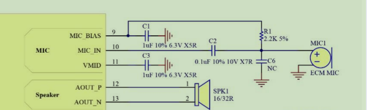

<?xml version="1.0" encoding="UTF-8"?><rss xmlns:dc="http://purl.org/dc/elements/1.1/" xmlns:content="http://purl.org/rss/1.0/modules/content/" xmlns:atom="http://www.w3.org/2005/Atom" version="2.0"><channel><title><![CDATA[请教下FR8016音频这一块如何配置？]]></title><description><![CDATA[<p><img src="/assets/uploads/files/1617093865454-90d70e9231fb6e70a2eecf803046bed.png" alt="0_1617093849116_90d70e9231fb6e70a2eecf803046bed.png" class="img-responsive img-markdown" /><br />
请教下FR8016这一块如何配置，我想和MIC采集声音信号做FFT分析，还有音频文件是否可以截取播放时长分段播放？</p>
