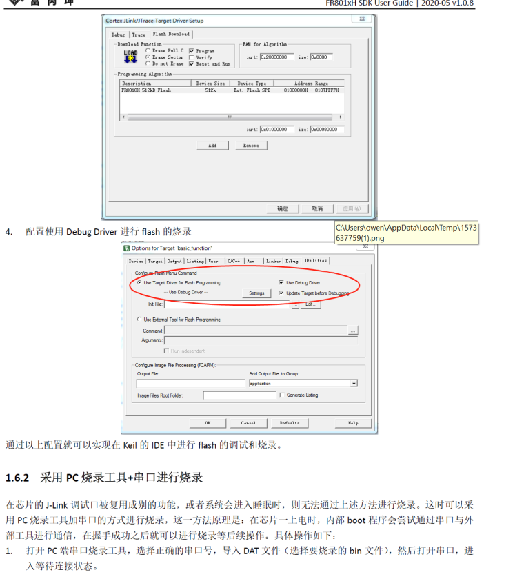

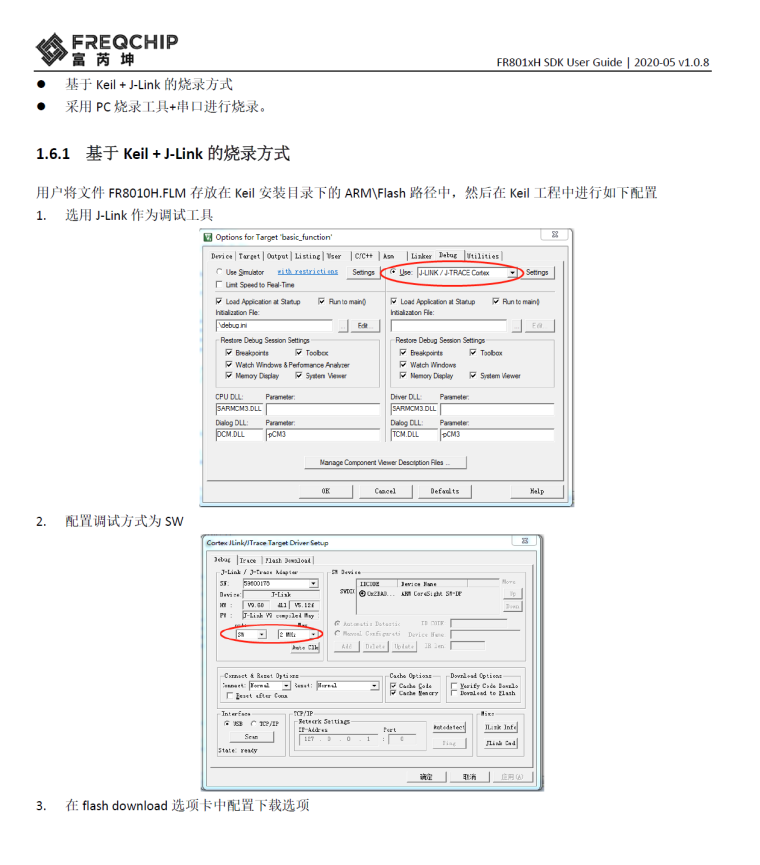

可以下载并且复位后正常运行,但是无法debug 提示: Full Chip Erase Done. Programming Done. Contents mismatch at: 00000100H ! Verify Failed! Error: Flash Download failed - "Cortex-M3"
选择Erase Full Chip也不可以
